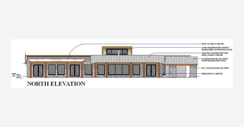

Colored elevations
What I'm trying to do here, is have a colored elevation of a 3D modeled building. I couldn't get the colors to appear on the elevation (shadows yes, 3D hatching yes, but no colors). What I've done is render the thing in a parallel view (hence elevation), saved it as a Plotmaker file (can't save it otherwise while keeping the object info), imported it in Plotmaker to open the PMK and copy-pasted it back into ArchiCAD. The problem is that I get 6400 fills that are all degenerated, and are all different from the PMK.
The point behind this is to paste together all the color elevations from a bunch of building made by different companies to end up with a streetscape of the whole block.
Thoughts anyone?

COLOURED PLANS - THE SECRET REVEALED!I HAVE BEEN PRODUCING COLOURED ELEVATIONS/SECTIONS REGULARLY FOR THE LAST TWO YEARS WITH FANTASTIC RESULTS.
THIS IS HOW I GO ABOUT IT.
This is the method that I use to generate coloured plans directly from the Model.
There is no cutting or pasting required.
Although it is a very simple process, it took over two years to discover the ‘secret’ of how to go about it, and this technique has now transformed the humble working drawings into a virtual work of art. It reminds me of when you walk into an old building and see an old set of plans framed on the wall touched up with water paints.

1. Pens & Colours - Open up Option > Pens & Colours.
2. Customised Colours - If you do not have the required colour you need for a certain element, you need to create it in the Pens & Colours Dialogue Box. I have a number of spare pens left white so I simply double click on one of these and customise the colour I need. If you do not have enough of a range in your standard Pens & Colours Dialogue Box, you may need to do this a few times.
3. Materials – Click on Options > Materials > Expert.
4. Create New Material – Click on any material (or one with a similar name to your proposed new material), and then click on Duplicate. Type in the new name and OK.
5. Material - 3D Hatching ‘Solid Fill’ – In the main Materials Dialogue Box under 3D Hatching (bottom of the dialogue box), select Solid Fill. Note: It must be Solid Fill NOT Empty Fill. This is the critical factor to the whole thing! Only a Solid Fill will show on the Section/Elevation as a solid colour.
6. Material - 3D Hatching ‘Custom Colour’ – Click the Custom Colour radio button (below Element Pen) with the little pen icon next to it.
7. Material - 3D Hatching ‘Pen Colour’ – Now click on the Pen Colour button and select the custom colour in the Pens & Colours Dialogue Box you previously created (or other colour if desired). Check now to see that the solid colour has been applied to the Material by looking at the right hand side of the Material button at the very top of the Material Settings Dialogue Box. Where there was either no window, an empty window or a Fill pattern, you should now see the little window turn solid black. This confirms you have correctly followed the steps. OK and exit. NOTE: It is always solid black little preview box regardless of what colour you select for the material.
8. Apply Material to Model – Select the entity on model you wish to apply the Material to; Wall, roof edge, WC, Window glass etc. and apply the material(s). Apply as many as you wish.
9. Section/Elevation Tool Settings – Open the Section/Elevation Tool > Set your Horizontal and Vertical Ranges. Click the main Vectorial 3D Hatching and Sun Shadows button to open settings and tick the Vectorial 3D Hatching and Sun Shadows boxes on. (The Sun Shadows is not required for coloured plans, but is used to enhancing purposes – see TIPS)
10. Section/Elevation Tool – Place the Section/Elevation mark on your plan view. For a quick method to open the Section/Elevation, hold your cursor on the Section/Elevation Mark and right mouse click (there is no need to select it first and then right mouse click as that is an extra click every time, times ten thousand per year). Open and enjoy!
11. Printing in PlotMaker – When the Section/Elevation is imported into PlotMaker, select the Section/Elevation, right mouse click > Drawing Settings > Show on Layout > Vectorial Colour Preview. This will display the Section/Elevation in colour just as you see it in ArchiCAD. At this point in time I have found no way to switch off the full colour for check plots. The Options > Preferences > Miscellaneous > Fill Background Colour does not affect the colour on the surface of the models element, only the colours in cut elements can be switched on or off.
12. Moving The Section/Elevation Marker Line – I have found that sometimes the Section/Elevation Marker Line may need to be moved a fraction to regenerate the Section/Elevation and update the colours on the Section/Elevations. Don’t know why this is, but just is!
Experiment, try different colours for glazing, green or blue tints look interesting. I have used a pitch-black glass on the Existing portion of our 1882 Railway Gatehouse building and the medium grey on the Proposed. Looks great and it helps to visually distinguish the new from the old.
Enjoy and wait for those ‘oos and aahhs’! They are pleasant to the soul and much deserved for any job well done!

Here is a rendered elevation, drawn to scale, and placed into Plotmaker. The file size is a bit big, but if this is what you are trying to achieve, then here is how to do it:
Make a mesh or slab base to the model to a known square dimension, say 50mx50m
Set up a 3D window as an elevation view and place the sun in the correct location to get your shadows right. Save it as a view in navigator.
If you want to generate a rendering at say 1:100, set the 3D rendering window size to 500mm and note what pixel size that comes out at.
Render the view and save it as a bitmap image
Load the bitmap as a hotlink into Plotmaker and make sure that the frame size is the same pixel size as the original. Then crop the window to suit your layout.
Plot the finished drawing, but do a double check using a scale to make sure you haven’t forgotten anything.
You will obviously need to re-render the elevation when you make changes to the model, but as long as you keep the bitmap file name the same, working from the saved view, then Plotmaker will update it when you next reload.
I hope that helps.
