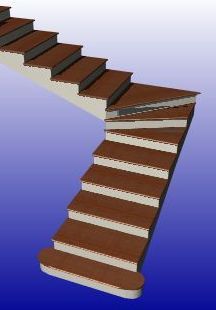

Is there a way to use ArchiStair 1.0 to model a set of stairs that start (end) with a commode step. ArchiStair can model a step that is curved across it's entire width but is ther a way to get it to model a step as shown in the image below?
Is there an alternate way to model a stair with a step that is curved or rounded on one side?

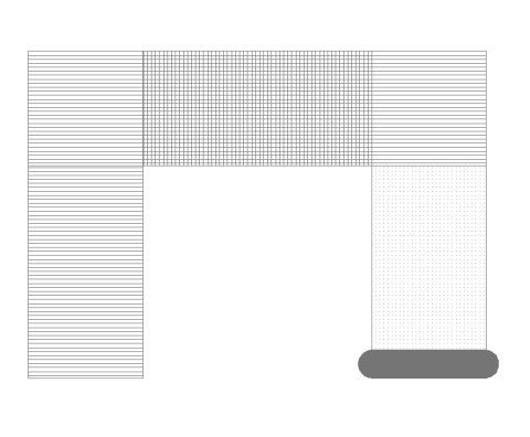

Have a look at the ArchiStair manual, page 56 - Custom Stairs.
I'm about to give it a go...
Gave it a go, it works pretty well.
Here's some fills drawn to the shape of my stair:
And here's the stair that Archistair created.
