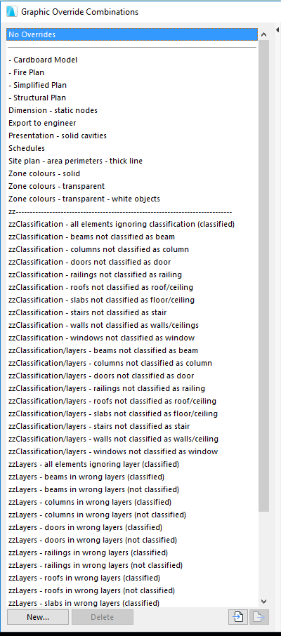

  • What is one thing that you would definitely improve on the way Graphical Overrides currently work? - Expand criteria to match Schedules e.g. include Parameters so we can highlight objects with a parameter value etc.
The ability to override individual parts of an element or object.
i.e. override just one material (surface) and not the entire element.
  • How many Graphic Override rules and combinations do you have in a typical project? - About 50 rules & 20 Combos. Some for presentation, others just for auditing checks.
Probably only around half a dozen regularly used.
But I have set up many more for Quality Control to check if things are done correctly - this is a bit of an experimentation at the moment - not really used.
  • If you have many rules and combinations, how do you structure them? For example do you put numbering at the beginning of their names or add rules or combinations as separators? - I assign a prefix e.g. rules are "ABC-...", Combos are "GO-ABC-...". Folders would be a handy addition.
Currently assigning a prefix to keep those not used out of the way.
With no folder structure, this is all we can do.
  • How often do you need to manage rules or combinations? For example is there a BIM Manager who sets them up at the beginning of the project or do you need to edit them constantly? - Self managed. Updated as necessary to suit project requirements and checks.
BIM manager (me) has set up in template, and views set to use applicable GO.
A better method if importing/exporting and updating rules and updating GO would be appreciated. There is no way to update (override) at the moment from one file to another.
It is a case of import, duplicate, replace.
  • If you need to edit them constantly, what are the typical reasons? - Project scale & complexity
We don't usually need to modify them.
