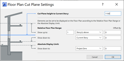

@Arpad Szabo I don't think there is much that you can change to improve the dialog which for me is constantly fine tuned as the plans develop.
The obvious and most important element is the cut plane which needs set to ensure it collides with openings. The OOTB 1100mm setting will never cover all situations. The one recurring frustration with this is displaying openings on the same story where the sill of higher openings are just above the head of lower openings.
The range limit makes sense once you understand how AC works.
I haven't really seen any point to the absolute display limit although I assume there is some logical reason for it.

My only issue with the dialog itself, which is unchanged since the FPCP was first introduced, is the direction of the arrow for "Show down to" for "Absolute Display Limit"... which points UP.  The other arrows point in the desired direction and so are visually meaningful.  Yes, I realize this is otherwise simply a label, but I think it is helpful for up/down to be visual as well.  My 2 cents. 🙂

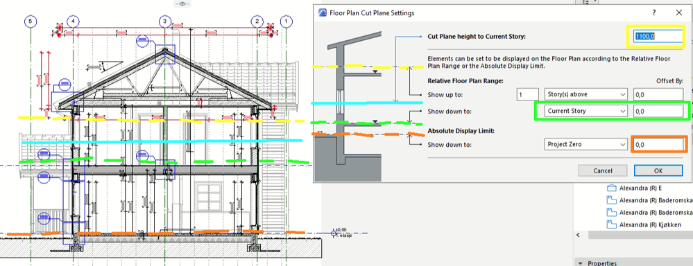

Made feedback post about this tool some time ago. At the moment it is very complex tool and I think it should be revamped. Also as many mentions this FPCP should be saved to plan Views settings same as "Layer Combination", "Scale" or other predefined setting.
More information and proposals with tips in following post:
Text and picture from other post: https://community.Graphisoft.com/t5/Wishes-forum/quot-Floor-Plan-Cut-Plane-Settings-quot-adjustment-...
Will help a lot if "Floor Plan Cut Plane Settings" can be adjusted in any Section/Elevation views with handles similar ones that are in "Section/Elevation Range" tool. This will help a lot when investigating why some objects are not visible in plan views 😉
Showing how these handles can be seen in section view.
