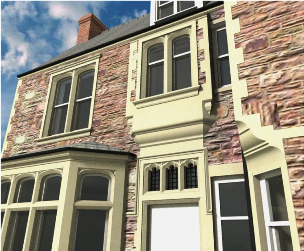

Try using OBJECTiVE - it will provide a very easy solution. You can see examples of OBJECTiVE used for making profiled arches here and here. The first video on the product page also shows how stone arches were detailed over windows (see attached image).
