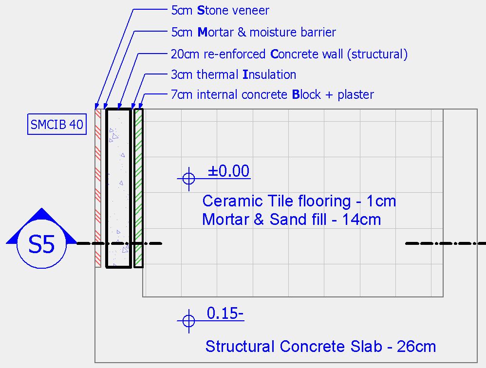

Here is an issue that I gave up on, but perhaps someone out there
has an idea.
Here in Israel we use "wet" building procedures for many projects,
involving the erection of a CIS concrete structure which then gets
covered with a stone veneer on the outside and insulation walls on
the inside.
For many years I would model this using a Concrete slab (C 26),
on top of which would "sit" a composite wall (SMCIB 40).
Finally, the slab would get covered, as in real life, by a second
"tile" slab (TS 15), creating a 15 cm sand-filled "subfloor" where
they run the pipe works and electrical cables. Real Hi-Tech !
(continued)

In section, I would have the same composite wall rise up from
the story below to "meet" the 26 cm concrete slab from the bottom.
This would result in a section "error" which I then have to
patch up to look right.
(see attachment in this and following post)

Then one fine day, the good folk at GS came up with the
brilliant "Complex Profile" tool. No Joking. Really.
Can this solve my problem, mom?
I set out to create a profile which would enable the composite
wall to sit flush with the concrete slab, while having the external
stone veneer cover the structures exterior without any brakes.
The profile was modeled with a "fixed" minimal hight, and much care was
given to the proper representation of the various materials constituting
the wall composite, and especially the fill boundary lines and
ending contours...
ending contours...

Take notice that the Mortar and internal Insulation were set to have
an "Air Space" fill and no fill boundary. Alas, I had to choose what to do
with the enforced Edge lines, and decided I could live with a 0.2mm
thingy.
Then I hit "STORE PROFILE" -
and all those boundary lines I told AC to NOT show popped back
as mighty 0.5mm lines....
