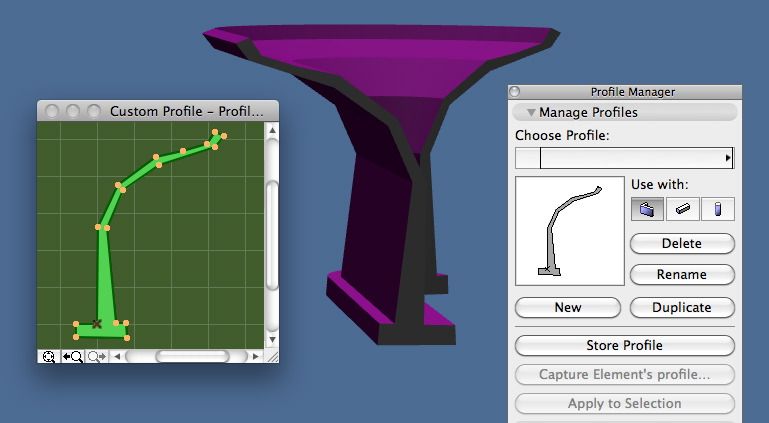

Hi.
I am trying to create a variety of faceted wall with different sizes and shapes in one wall in archicad14.
Would some please be able to help me assist on how about to do this?
Your assistant would me much appreciated
Dwight
That would be your complex profile wall:
Eric's Complex Profile Wiki Article
