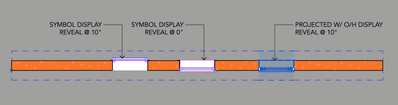

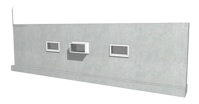

The issue is that in some of my complex walls, the windows in 3D think that the Reveal depth to Opening Reference dimension is relative to the inside of the wall, but in 2D, when using Symbolic view for the windows it's relative to the outside of the wall. A workaround is to use Projected or Projected with Overhead view for the windows so that 2D and 3D offsets match, but that's not acceptable for windows of heights that aren't cut by the view's floor plane cut level.
The issue is a construction line drawn in the complex profile, aligned with the edge of one of the fills (so not noticeable) which seems to serve as the opening reference. It just needs to be moved to the other of the wall, or deleted.

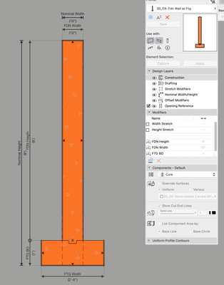

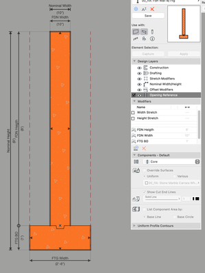

I'm curios about this, too. Could you post some pics of the construction line(s) you mentioned? I can only see the opening lines in my composite wall. I have a foundation wall w/ footing and I have a similar issue with it (see pics). Except my windows do not fit within the foundation wall portion, as it seems the footing width governs. My work around was to change the display but also to tweak the reveal values.
The red lines (opening lines) are shown on the faces of the foundation wall, but if i check and uncheck the visibility of the opening lines in the profile editor, the opening lines position resets to the faces of the footing.

Sorry, it took me a bit to get to it.  I think you were able to move/delete your opening line because your wall is the same thickness.
After playing around a bit, I discovered that walls of different thicknesses (like my fdn/ftg wall) by default will have the opening line/s aligned with the outside faces of the thickest wall, which I guess is ok, as long one is aware of it.
This is what I did:
1. I checked off the Opening Reference box, the opening lines disappeared and my windows aligned with the outside faces of the footing. When I checked the Opening Reference box back on, the opening lines showed up, aligned with the outside face of the footing and so did my windows.
2. If I moved the opening lines and aligned them with the faces of the foundation wall and SAVE the choice (here is where I kept screwing up!), the windows behave properly: symbol display in plan, aligned with the faces of the foundation wall, both in 2d and 3d.
3. If I erased one or both of the properly aligned opening lines, I was back to #1.
