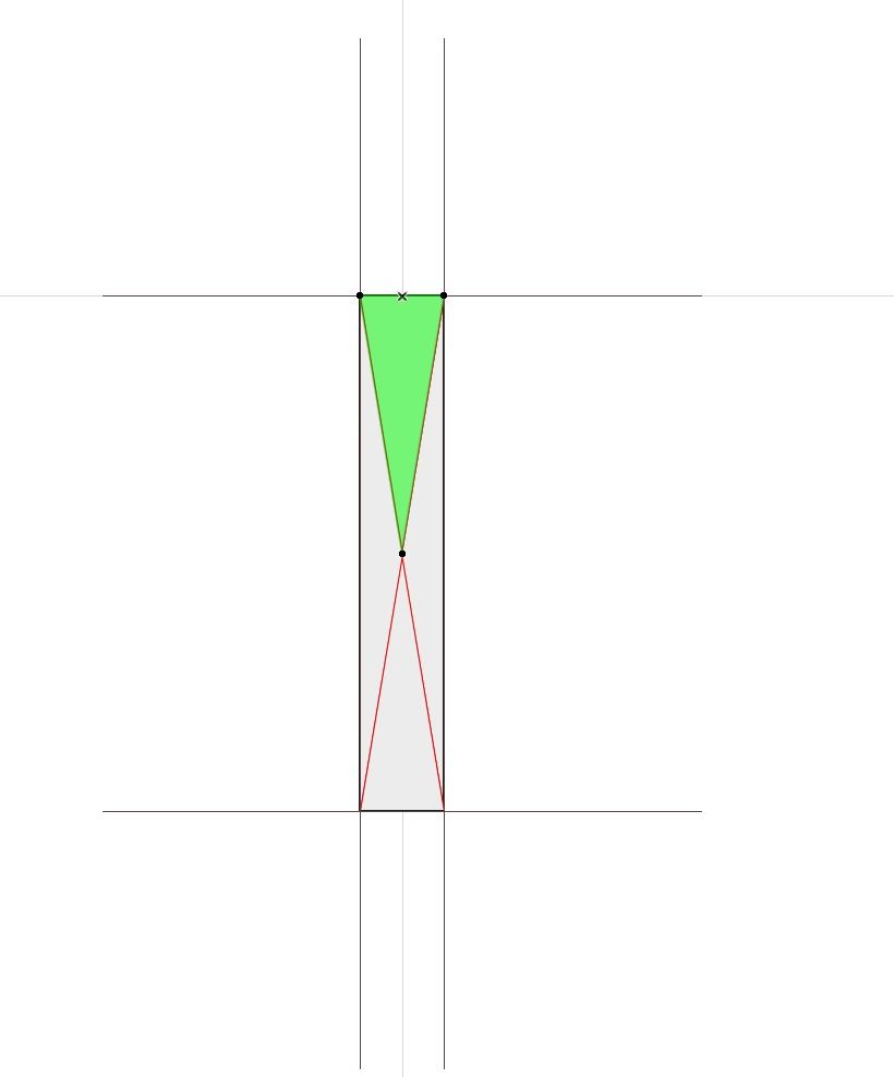

I've made a 2x10 framing member with the CP tool. I've broken the rectangle into 4 triangular pieces so I can get the "X" in the middle of the rectangle. Problem is, when I cut a section and if it happens to be in the middle of the framing member, I get an unwanted line in the middle of the member. This line is there, I believe, because it's the point where the 4 triangles come together. Is there a way to do this to not show the line? I found a 2x framing member in the stock libraries, but it does the same thing when cut through, also I don't like it because you can't set the lineweight of the "X" different from the outer edges. What have others done here?

All of those issues are handled with the complex profile. If you add hotspots to the 4 corners in the complex profile, then they'll all have nodes in section/elevation.

Hi Jared, When I first tried the complex profile, the main problem with it was it would merge in plan when you butted them. So never used them again. From your post its easy to do the sides with different fills but how have you got around the tops merging? Objective a least doesn't merge in plan, which brings up the question. Why does it merge in section and not in plan?
Imac, Big Sur AC 20 NZ, AC 25 Solo UKI,
If I understand your question...
Not merging in plan is a little tricky but doable. If I remember correctly (just closed ArchiCAD for the dayshift, so I can't double check). Assuming you're using the beam tool, if you use the adjust tool to bring the beam to the edge of the one it meets (perpendicular), the reference lines won't meet and the beams won't merge. But this can get tricky, especially if you later fiddle with the beams sometimes shift and merge their reference lines.
Another option to handle this is with layers. If you have a primary and a secondary layer (say joists vs. beams) then you can control the merging with intersection groups (which is what I do when it matters).
