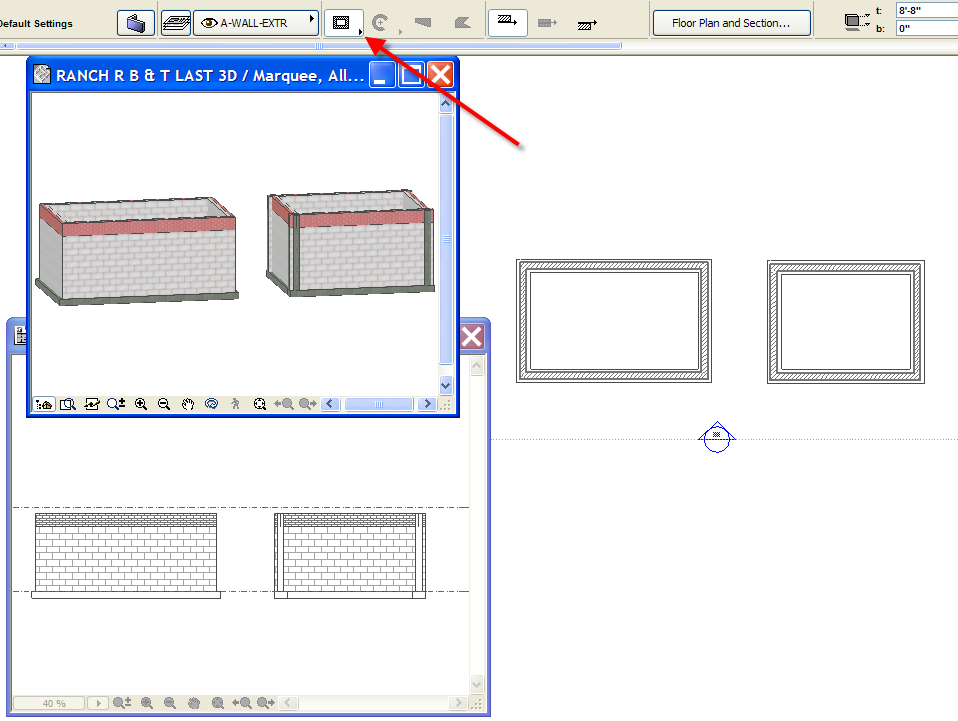

Hello
I made this complex profile. It looks ok in plan but in 3d & elevation the corners go all the way out to the edge of the footer.I was wondering if the point of origin might be the problem but it doesnt seem to fix it if I move it. I hope the screen shot shows enough to see what I am doing wrong. Also is there a way to change the footer line to a dashed line.
Thank You for any help

It is probably not a good idea to have the footing included with the wall anyway.
It's fun to see all that modeling being done at once but in the end it is really not very useful. You can add the footings under your walls with a single click and keeping them on a sperate layer may be important too.
It all depends on how you go about designing things.
Drawn separately there is no problem getting your footing to show up with dashed lines.

I tried to replicate your problem and it worked perfectly regardless of where I placed the origin. Did you check that the two elements are intersecting exactly?
BTW I also find it more useful to place the foundation separately but it's a matter of choice.

I'm not sure what it is it only seems to do it with that wall. I made another one in a different file and it came out right. Then I copied it to the original file and it worked there. And I made a new one in that plan it also worked. Must be something I did in the first wall. They should be intersecting exactly I used the rectangular geometry.
Thank you for your time

It sounds to me like you may have missed the mark with the local origin in the profile editor. This is according to Graphisoft literature:
The generation of the Profile happens according to the following rules:
In case of Walls: if you are looking at Wall from its starting point toward its endpoint, and if you created the Wall using the Left Construction Method (i.e. the body of the Wall extends to the left side of the Reference Line) then the placed Profile wall will face the same direction as shown in the Custom Profile Editor. If you switch the wall’s Reference Line to the other side, or if you view it from its endpoint toward its starting point, you will see the vertically mirrored image of the Profile. The Local Origin of the Custom Profile will placed at the Wall insertion level (base height) as defined in the Wall Settings dialog.
It would probably be best to upload a module of these walls for closer inspection.

I selected both walls with all layers on. Then File>External Content>Save Selection as Module. If I need to do something else please let me know

BAS - there's something strange with the geometry of that first wall. by moving the complex profile's origin (or actually moving the complex profile itself relative to the origin) it cleans up most of the junctions . . . also, there looked to be some duplicate stretch lines going on in there that possibly weren't helping.
but! there is always one junction that won't close properly. when selection highlit they display with some strange co-planar geometry . . .
anyways. a new profile seemed to work, no?
~/archiben
