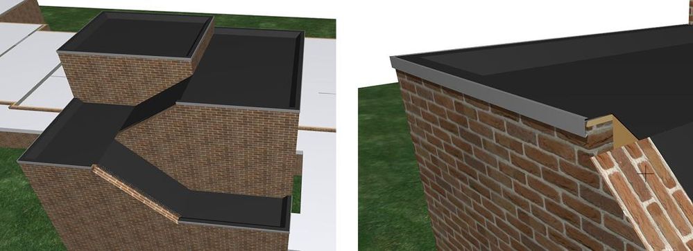

Hello,
Trying to construct this staircase building with a complex roof.
I made the triangle walls with morphs and made an roofedge with the profile manager.
Can't draw the roofedge above the triangle morph walls.
Any suggestions?
Greetings

Set the roof edge profile for use as a beam, then draw roof edges as beams and inclined beams?
Dontknow
Thnx for that info. That worked pretty good!
