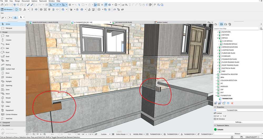

Has anyone experienced this interaction between two identical complex wall assemblies?  I have tried adjusting intersection priorities, but the bottom of the wall assembly (where sheathing, mineral wool, and stone overlap the foundation) seems to not respond to those priorities?
Help?!?

This has popped up a few times... There are posts about it around here somewhere... Put your footing in a different Intersection Group. The issue is that they are trying to connect to your footing. Playing around with the Junction Order of your 4 walls at each instance can sometimes work.
https://community.graphisoft.com/t5/Modeling/Wall-quot-wings-quot/m-p/293426

@Lingwisyer this worked like a charm, thank you!!
