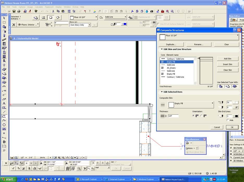

I am having trouble with my composites. I just noticed that the separator lines were not showing up. I did not have this problem a few weeks ago but now I do. I have recently installed the latest patch but I do not know if this is causing the problem.

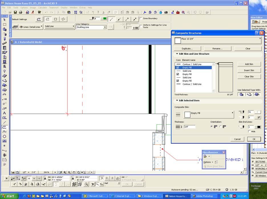

I did some more investigation and found that the problem seems to be when two adjacent fills are the same then the separator line does not show up. As I mentioned, I do not think that this was previously a problem.
I did change the adjacent fills and this seems to have fixed the problem.
As we now have the separator lines it seems that this is cumbersome and unnecessary. It would be easier for me if the fills could be the same--in my case: Empty Fills--and have the separator lines show up too.
Is this the way that the adjacent fills are supposed to interact?
