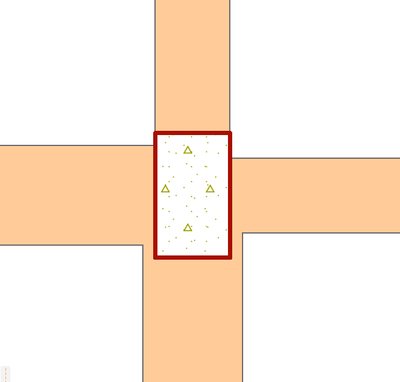

Connection between beams with different widths
LeeJaeYoung
I want to make sure there are no overhangs where the arrows are, but I think this is the best solution.
How are you doing?
in REVIT
If you do not combine with a disallow join in the revit and place it in the desired location, it is automatically combined.
AC27 on window 11

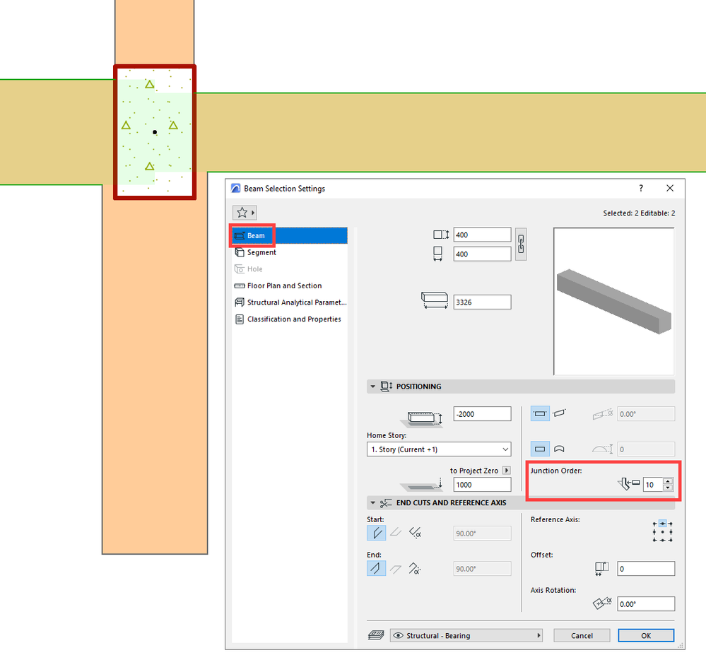

1 ACCEPTED SOLUTION
Solution

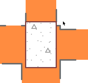

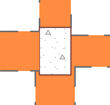

Here is how you can achieve it:
Make sure that the Junction Order value for the two horizontal Beams is set to a higher number than for the two vertical Beams. That way, Archicad will first connect the two Horizontal Beams, then it will join the two vertical Beams after, resulting in the desired junction geometry.
2 REPLIES 2
Solution
