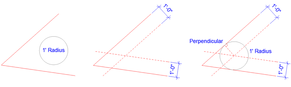

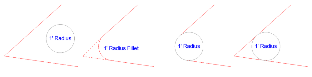

johanes wrote:Does the tangential method not work for you? Haven't used it myself (and don't have AC in front of me) so not sure if the third point can be a radius by simply typing "R" before input.
Someone asked me this question: how to build a circle with a given radius, tangent to two concurrent straight, flush, some?
At first sight the problem seems simple, but try and tell me some how.
