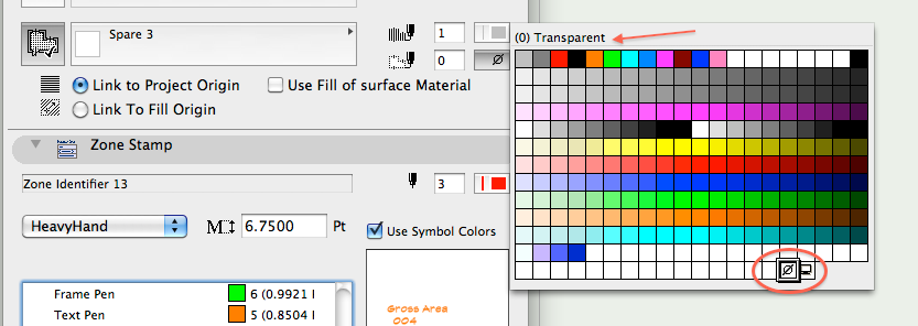

I will print the file with listed zone(active) and the reference dwg(reference) below. Could anyone tell me whether there are any possibilities to make the color of the zone to be transparent or half transparent when the file is printing out?

Is there any transparent color to choose?
Pen (0), See attached:

Thank you! I think I will not find the transparent color without your help!
