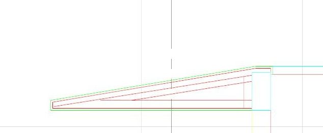

I am having trouble creating this canopy as it consist of two panels. One on the top (sloping) and one on the bottom (90 deg).
The photo shows cut section.
The frame is attached to the beam.

The [green edges] lateral panels [if smooth] can be created with a complex profile wall.
