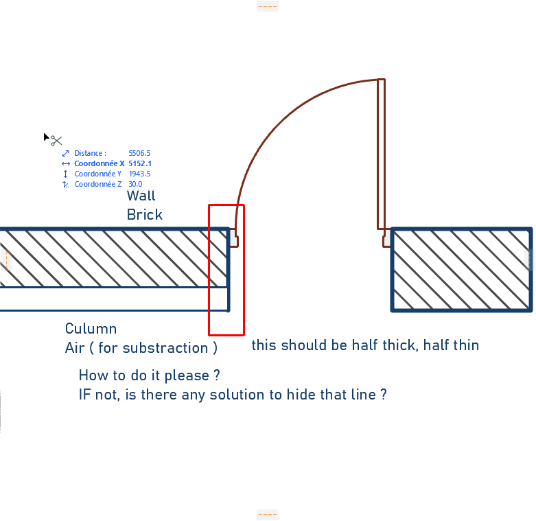

Hi, i always encounter this problem in the design process,
making wall recess don't always give a clean result in floor plan, i used several methods, using niches, column / beams with a higher material priority,
in this exemple i used a column,
is there a solution for that ?

Hi, do send 3D view of this wall n door area. Any plaster surface you are willing to show on as outer skin of wall?

Yes i'll need to add a thin plaster skin later

Here is à sketch, i’m not in office tokay

Rajesh Patil
try this Option-1 :2021-09-12.png
Option-2 : Define new door with two unique ID's Wallhole & Wallniche.

Rather than SoE-ing, could you instead us a Wall Niche?
