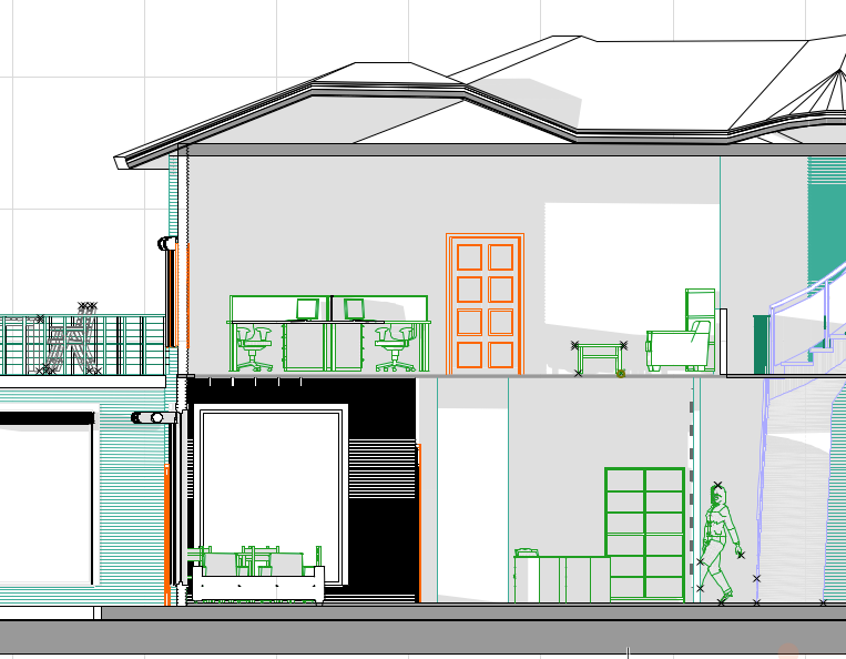

Hello,
I was wondering if anyone could tell me why I have these cross signs on sections 3d Models.
Would appreciate if anyone could help me to resolve the problem as soon as possible.
Many thanks.
2 Replies 2
rocorona
Do they appear in printed copies or only on the screen?
They seem to be simply Hotspot elements (if so, they stay the same size if you zoom in or out).
Did you try to select and delete them?
Fastest method... Make the "Hotspot" tool active.... Edit> Select All (Keyboard shortcut on a Mac is: ⌘A) Delete or change to a hidden layer. They won't print.
