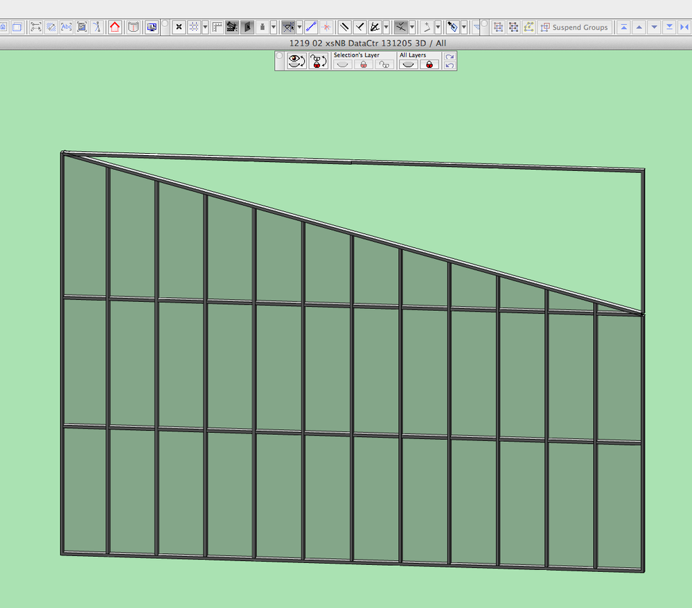

Before I throw AC17 out the door because every time I work with the curtain wall tool, I absolutely can never get it to do what I perceive the way things are built…
Now in this case, I am trying to do a trapezoid shape, 36 feet wide, 16 feet on the low side and 25 feet on the high side…the slope happens to be a 3/12 pitch. I cannot get rid or delete the exterior, in this case the top frames and the 9 foot high frame on the side.
Is this impossible? I am sure it's possible because I saw someones rendition of the Eiffel Tower using the curtain wall tool. If he can do that, what am I doing wrong?
How do I move, modify, or delete frames, mullions, transoms?
How do I generate this type of storefront view? I'll pull my hair out later trying to install doors that never seem to be right…
Pretty frustrated… How can I do BIM if I can't model?

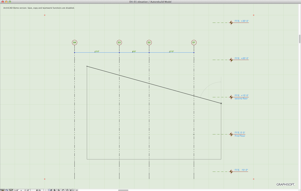

You can draw it in elevation using the Boundary method.
See page 12337 of the Reference Guide.

Eduardo Rolon
drawing

Eduardo Rolon
result
