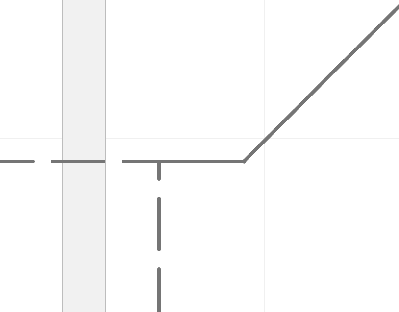

line up dashed lines that overlap ?
is there a way to get dashed lines that overlap to line up so they appear as a dashed line? i have two slabs that meet, each has a dashed line, but where they meet the line appears to be solid. can you shift them like you can align textures or something?
wb
2 REPLIES 2

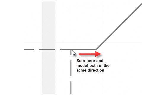

AFAIK These linetypes get their origin from where you start the slab, then just follow the polygon you draw.
You could get a few to line up nicely, by starting them both in the same location and modeling them in the same direction (using the polygonal geometry method), but you could easily find yourself chasing your tail when the problem occurs with the junctions of other slabs.
I don't know of any other way around it.
Cheers,
Link.

thanks, it's a start and more than i knew 2 minutes ago.
wb
that worked pretty well, thanks link.
