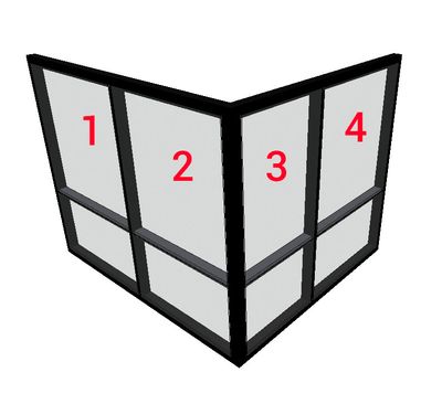

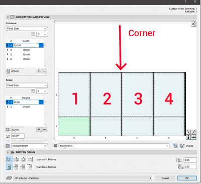

Hello Christophe,
What I would like to achieve is shown on the following screenshots.
This is the scheme in the order it is supposed to appear, it doesn't matter the pattern origin:
I want to achieve this pattern:

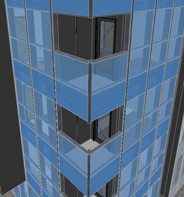

But the result is this:
The pattern always starts from the beginning at the corner, so I can't create curtain wall with unique pattern at the different sides.
As I said I don't like the custom editing of the curtain wall, I don't think it's reliable for big projects.
Cheers!
Thank you for the clarification. It is indeed much easier to understand that way. At the moment I am performing the same analysis as you and I am unable to get the result you want. I am nevertheless continuing my investigations.
