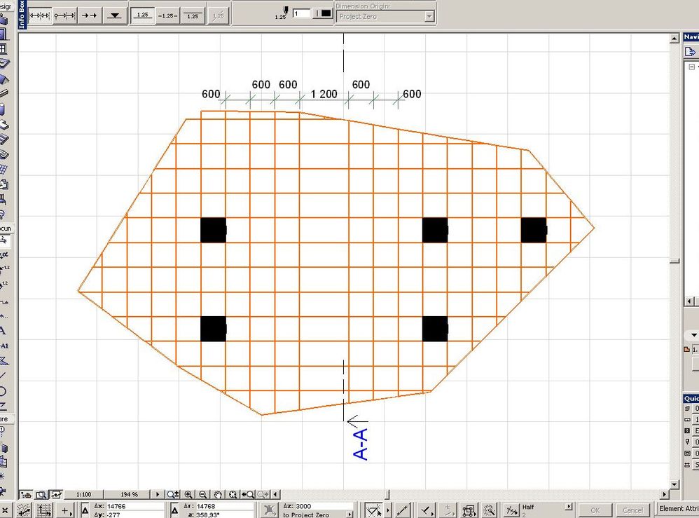

Hi!
If someone hasn't thought of it, you could use curtainwall to make your ceilingplans. And you get much better result than use slabs with a fill.
9 REPLIES 9

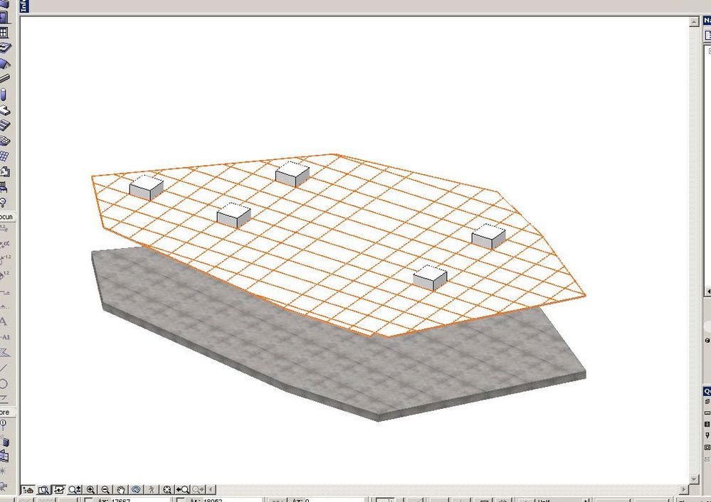

and second picture

doesn't show that in my picture, but there the boxes are, there isn't any panel ofcause. no collision
