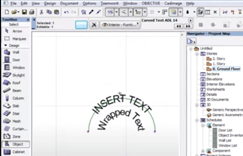

The download link to the curved text tool is no longer working.
It seems there was a tool available before that was simply called "Curved Text Object" by Applecore Designs. The GSM text object seems to have been commercialised for a while, but now Applecore Designs has ceased to exist. Maybe the text tool is lost on us, except if past users are willing to share.
Archicad Object: Curved Text Object - Youtube Video
Pretty frustrating Graphisoft does not provide a native tool for basic 2D curved text. Or keep their links valid.
