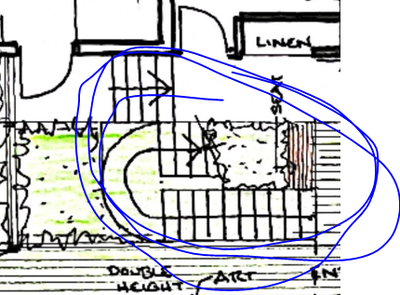

Curved stair landing - help
Help please - I want my landing to be curved like this (1m raidus the whole way round)
How would i do this please?

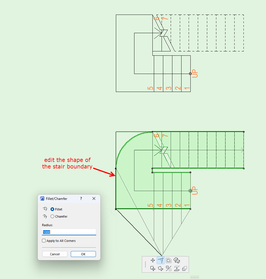

1 Solution
Just create a stair with a rectangular landing and the edit the boundary of the landing (not the baseline).
Go to post
1 Reply 1
