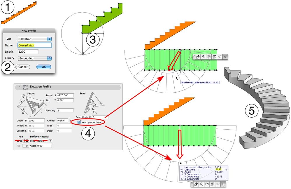

I'm trying to curve a stair so it will be flush with a wall, but I'm having trouble figuring out how you can change the bend of the stair.
I've seen a few forums on this using the OBJECTIVE tool, but I really haven't found anything actually describing the motions of how to do it.

You can use OBJECTiVE to do the following (refer to the attached image):
  • 1. Draw a cross-section through the stair with the fill tool;
    2. Select the fill and make a profiled object from it with OBJECTiVE > Component > New Profile. Note that you want to make an Elevation profile. The tool will prompt for an anchor point and bending axis when you create it - the bending axis in this case is horizontal;
    3. The New Profile tool places an object over the original fill - use OBJECTiVE > Tools > Rotate to rotate it into the correct orientation;
    4. The object has a hotspot at the centre to bend it to the required radius. Note that you can control the profile proportions in the object settings - if you set it to Keep proportions, the object profile won't be stretched as it bends (refer to the 2 examples).
    5. The results in 3D

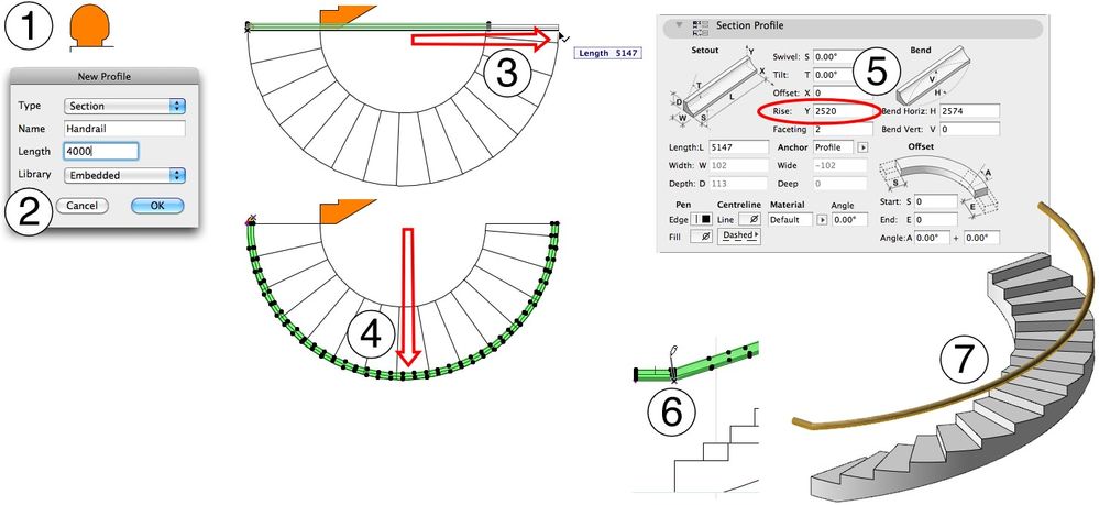

I'll follow this up with a method to add a handrail.

You can similarly add a handrail. Referring to the attached image:
  • 1. Draw a cross-section through the handrail with the fill tool;
    2. Create a new profile object using OBJECTiVE > Component > New Profile. Make it a Section profile this time, and set the anchor to the point that you would set out the handrail from (probably the centre base);
    3. Stretch the profile object from the handrail start to end;
    4. Use OBJECTiVE > Tools > Bend to bend the handrail to the stair perimeter;
    5. Set the overall handrail rise in the object settings (or use OBJECTiVE > Tools > Offset in an elevation view);
    6. You can place other instances of the profile where it levels out, and use OBJECTiVE > Tools > Split to cut the objects at the junction (in plan or elevation);
    7. The finished result in 3D.
Hope this helps.

Hi Ralph
Well, guess I'm confused here.
And sorry about the dumb question, but:
Is the stair you show made and manipulated in Objective or is Objective being used to modify an Archicad stair?
lec
It's made and manipulated with OBJECTiVE (see steps 1 & 2 of my first reply). OBJECTiVE can cut or rotate a StairMaker object, but not bend it.
