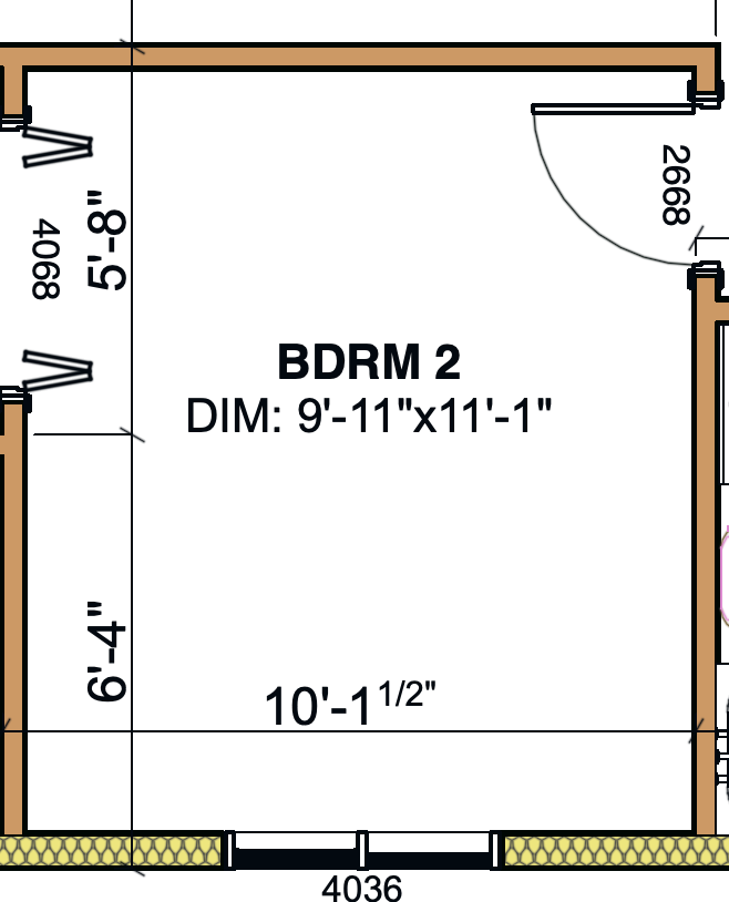

I have a custom text setup in my Zone Stamp. Where do I edit the value of this custom text? Looked everywhere. Achicad 25

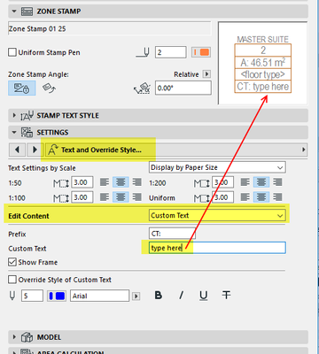

‎2022-07-28 05:02 AM - edited ‎2022-07-28 05:03 AM
I don't use these zone stamps and it took me a while to work it out.
Zone Stamp 01 is set out differently to Zone Stamp 02.
in 01 ...

Wow. Thank you Barry! I must be blind. Was looking everywhere. Yes. this is where it is.

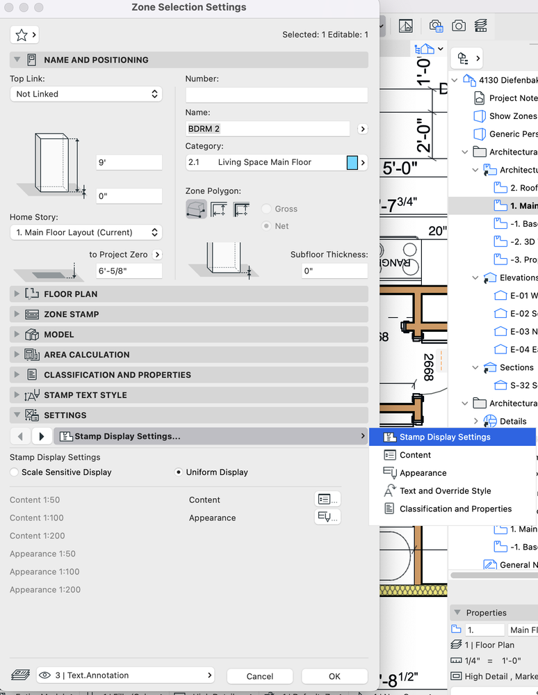

I would assume it is in the settings for the zone stamp.
What stamp are you using?
Can you show a screen shot of the stamp and its settings?

‎2022-07-28 03:28 AM - edited ‎2022-07-28 03:28 AM
I thought so too. Funny thing I set up those Custom Zone. Can't find how to edit values in 25. In 22 it was in stamp settings. I need to change DIM values can't find where.

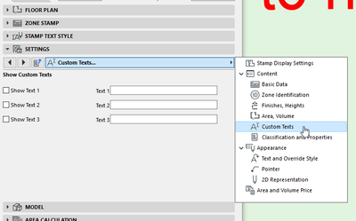

In the 'Stamp Display Settings' what do you see when you click on the 'Content' button or browse the interface pages.
Is this custom text in the 'Custom texts' page?
This image was from 'Zone stamp 02 25'.
I can't tell from those images what zone stamp you are actually using - I might not even have it in the AUS library.
But if you can say what the name of the zone stamp is, I can see if I have something similar.

I am using Zone Stamp 01 25. I don't have the fields you have on your screen for some reason. I used to have them. I remember it was easy to make changes. Now that the custom text section is gone.
