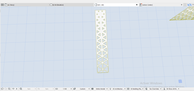

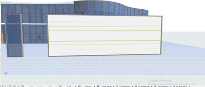

I've created a pattern with the morph tool and saved it as custom curtain wall panel but when i try to apply it on my curtain wall it only give me a white plain surface.
i've tried lots of youtube tutorials but nothing worked... please help me if you can.

Not so sure, but maybe your dimensions are too wide in the CW settings for this one panel of your own design? If so, make the panel size the same width as your custom panel is designed.
