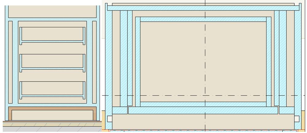

I am looking for solutions for my problem. Is there any way to get a cut line in sections between different elements but made from same materials? In horizontal section you can see each element but in vertical section everything looks like a one shape.
(Vertical section is on the left side of the attachment)

If you duplicate the material and give it a different name then you can use the different material to force a joint line to appear.
An alternative would be to put the various components on different layers and prevent them merging using the intersection group number...

For this reason we have up to 4 different buildingmaterials for basically the same material with increments of 1 in priority (for example 600, 601, 602, 603) for laminated wood panels, wood, MDF, etc. It takes a bit of planning when assembling furniture, or fine trim detailing, but it results in clear and readable sections.
Similar problems occur with concrete (prefabricated element assemblies).
It helps to have multiple fills too, once you start using the same ones for windows/doors/skylights/objects. These do not use buildingmaterials, but tend to merge similar fills touch in section.
Let's say you have a wooden window frame set in a wooden panelling facade, if they both use the same cut fill, they will merge. Or empty fills for the air cavity and empty fills for frames. It's a 'problem' we get a lot at early stages of design before going through some of the sections to fix it.
Regarding intersection groups: these work like a charm, until you start saving stuff in to hotlinked modules and everything in the module behaves according to the intersection group number of the hotlinked module 'master' layer, rather than the layers of the hotlinked elements. Not cool

This works for me. Thanks a lot!
