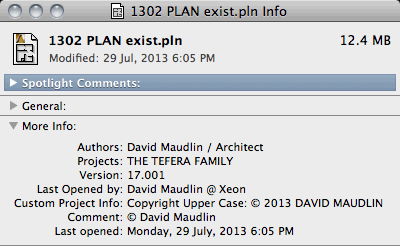

Just noticed this for Mac OS 10.8
"Quick Look/Preview"
Selecting the file and hitting the spacebar shows the version.
...and "Get info" seems to work again with AC17 files
(Not sure if the change is due to AC version or Mac OS).

Similar for OSX10.6.8 with Get Info, Quick Look/Preview does not have the version number.
David

We DO NOT see the version number ever in Get Info. OSX 10.8 AC17. We do get it most of the time in Quick Look. It's interesting, we don't get any of that info under the more info tab, just last opened. Could it have something to do with the way the server is configured, all our files are stored on a server.
