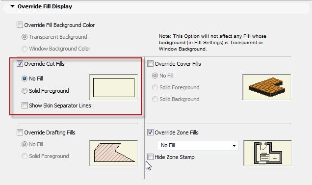

I'd be checking the override cut fill option in your model view options.
Cheers,
Link.
