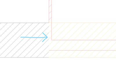

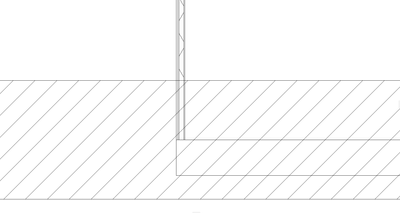

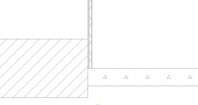

At my office we've been noticing that when we use renovation filters some lines that should be visible in section are not.
Between an existing mesh and a new wall, for example.
If the polygon of a demolished mesh and an existing one coincide, I understand why there would be no line, but I don't think the wall should have anything to do with it.
This is best explained by the pictures attached.
Any thoughts?

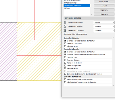

Try changing the override filter settings and place a checkmark into "Do not intersect" option of the To be demolished part:

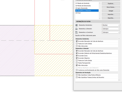

Hey
I've been trying to replicate the issue, as I don't remember where the issue was.
The "Do not Intersect" option does make a difference, but only if you don't make both Existing and Demolishing not intersect, strangely enough.
Personally, I don't see why would mesh and wall ever intersect.
Attaching pictures for reference.
