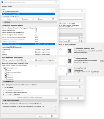

Do I have to do something to get this information in my IFC-eksport? Or is already mapped in the standard IFC-exporter??

You need to specify in the IFC Translator > Geometry Conversion for IFC Export > how you want the IFC Model position defined. If you use the new native Survey Point you should choose the Survey Point and Project Origin option. But in this case I guess you'd need to have Easting and Northing defined (and elevation) which you don't have in your screenshot.
Take a look at the Native Survey Point Workflow Guide. I's free if you are on SSA.
The Georeferencing parameters for IFC work as IFC data only and don't  affect the Survey Point location in Archicad.
If you don't use the survey point method I think the Georeferencing data will place your model in the right spot, but the export translator must be set differently. I haven't tried this as I always use the Survey point.
