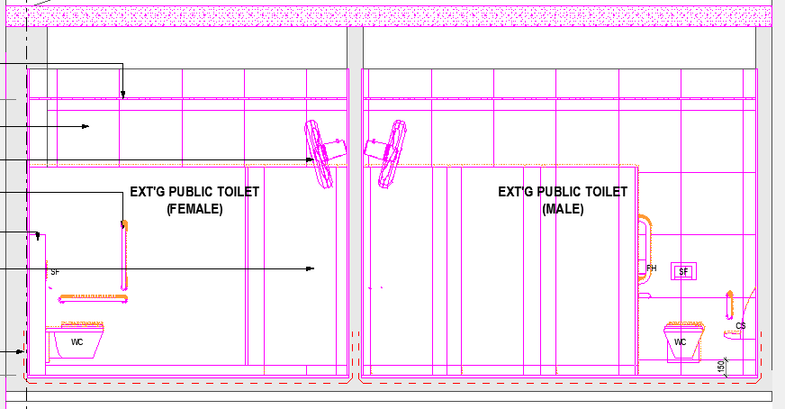

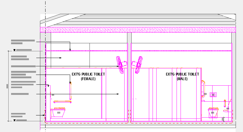

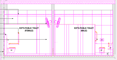

I am having an issue with the display order of a fill displaying incorrectly in section when viewed by different participants within a teamwork file.
As seen in the attached file the section should appear like in (Hatch Correct), when viewed by another account on the same teamwork file it appears like in (Hatch Incorrect). The 2D fill element displays incorrectly behind the 3D wall element when view by the other account, when it is in front of the wall with the correct display order when viewed by myself.
Hatch Correct.pngCorrectly displayed
Hatch Incorrect.pngIncorrectly Displayed
Please advise if there is any solution regarding this issue. Thank you.
2 Replies 2
Noemi Balogh
Unfortunately display order of 2D elements are not transferring over the BIMcloud. Check this article out: https://community.graphisoft.com/t5/Teamwork-articles/Display-order-of-2D-vs-3D-elements-in-Teamwork...
Even if it's old, this is still probably your best way to workaround this situation.
