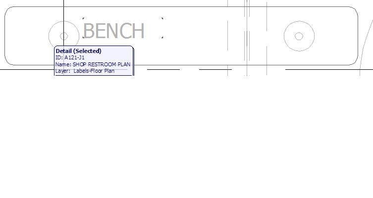

In the picture attached, the smallest circles represent columns that are 1' AFF. The rectangle represents a slabe at 1'8" AFF. I have sent the columns to the back and brought the slab to the front and they don't display appropriately. Any suggestions?

Does the slab have a cover fill in it? If not, there's nothing in it to hide the columns below.
Tom Waltz
Thank you!
