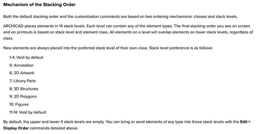

Hi everyone. I've been playing around with display order issues the last few days as they have been causing a few headaches on our projects. Am I right in thinking this extract from the online manual has the stack order the wrong way around?
In reality, Figures are on 5, Zones & 2D fills on 6, 3D strucutres on 7, Library parts on 8, 2D artwork on 9 and Annotations on 10.
Or have I misunderstood!

Yes it seems the default display order may be a little different from what you show in that documentation (I am not sure how old that is or where it was from).
You can check the display order by placing a few different elements, select them and use the 'Element Information' tool to see what the display order is.
I find it really doesn't matter though.
99% of the time it is OK.
For the few times it is not, I have a custom 'Arrange Elements' tool bar set up at the top of my screen. Slightly smaller than the standard one, and I have the lock/unlock, show all layers in another toolbar at the bottom near my layer controls.
Very easy then to adjust forwards or backwards.
If I get messed up, I just reset.
What the actual order is, I really don't care.
