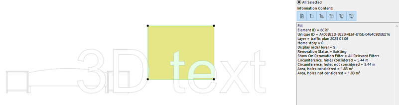

I replicated your situation and I am facing the same issue. The fill element changes its display order level value, but the 3D object doesn't.
here I have a fill on display order 9 and the text on 3 but the text has been brought to front (so it shows in front).
Also when I bring the text forward, the display order value does not change. It only does so in plan view, not in elevation.
Regarding the view placed on a layout though, it updates correctly automatically in my case.
