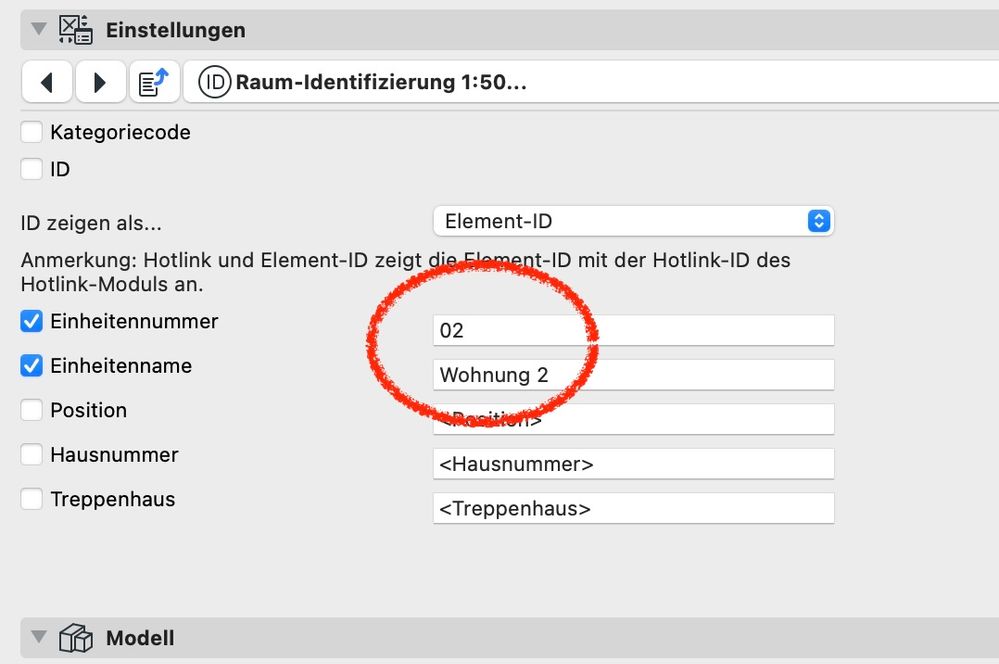

This is built into the German version of Archicad. See Screenshot. Going by your room names, you are dealing with a German project? Are there still "Bauverwaltungen" who want to see these calculations 😪 Or even double-check them?

‎2022-11-30 03:00 PM
Thank you, that's exactly what I need! Yes, indeed, it's a German project. I doubt they are going to check it, but still, you know, bureaucracy is bureaucracy)) We're just setting an experiment whether it's possible to make all this automatically.
But somehow this table is empty in my project, even though I've placed and named all the zones properly in the project.
Without knowing about this table, I've already made a similar table from scratch
Perhaps I must disclose some layers for it to work?

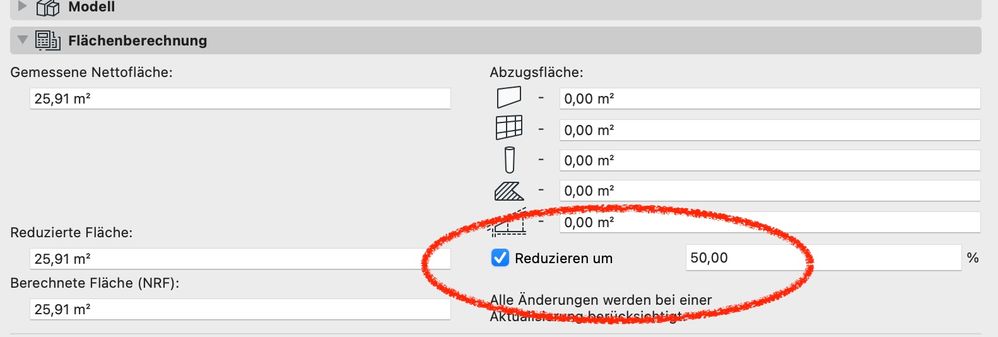

‎2022-11-30 03:23 PM
Beg your pardon, now I see it. It was in the settings. That works perfectly!

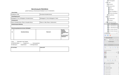

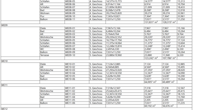

‎2022-11-30 05:15 PM
Excuse me, may I ask you please, how do I edit this form? May I set it somehow to calculate the areas of the balconies and the terraces with the factor of 0.5? And is it possible to devide these form by the apartments. That is make a separate document for each apartment?

‎2022-11-30 08:51 PM - edited ‎2022-11-30 08:57 PM
apartments :
balconies:
