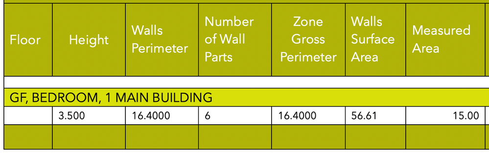

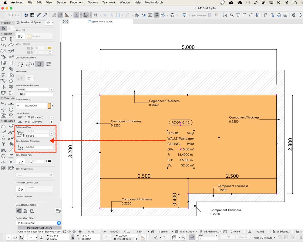

Here is a simple room I have:
The Zone stamp correctly calculates Gross Internal Area (GIA), Perimeter (P), Ceiling Height (CH) and Zone Volume (ZV)
When it comes to wall surface areas, though, which I need to track for decorating costings etc, it all goes haywire:

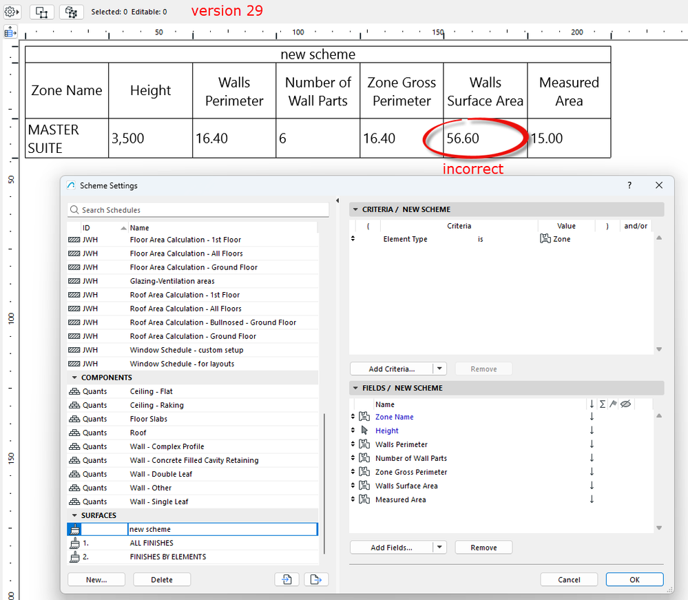

See how the Walls Perimeter (3rd column) and Zone Gross Perimeter (5th column) correctly show 16.40m; and Height is correct in column 2, 3.50m.
What a mess, though, in Walls Surface Area! I would expect the correct value, 16.40 x 3.50 = 57.40m² - not that weird 56.61.
And no, there is no error with Z values - everything (i.e. walls, zone) start at Z 0.0000 and end at 3.5000. No zone subfloor thickness, either (you can see it's zero).

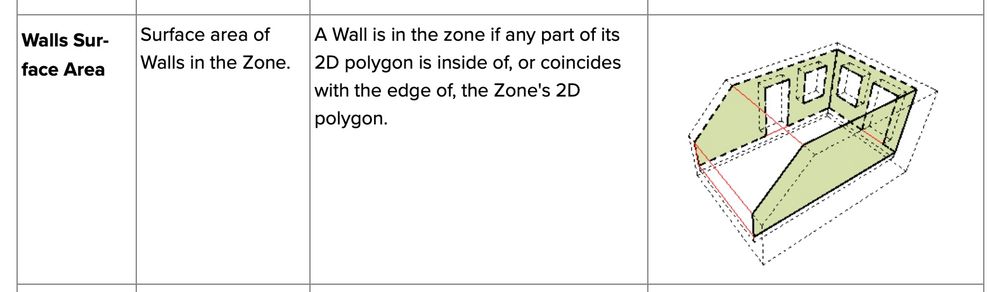

Another weird thing is that if I change all the walls' thickness to, say, 0.30, then 'Wall Surface Area" becomes 56.35, without any change to the walls' surface areas - at least not the ones facing into the specific zone, as per the explanation of how this parameter works in Archicad Help.
If I make the walls 0.10m thick, then I get 57.05m².
If I make the walls 0.35m thick, then I get 56.17m².
If I make the walls 0.40m thick, then I get 56.00m².
If I make them 0.50m thick, then I get the correct "Wall Surface Area" reading: 57.40m².
The correct sum seems to stay on after that; I changed the walls to 1m thick and it didn't change.
It's like voodoo.

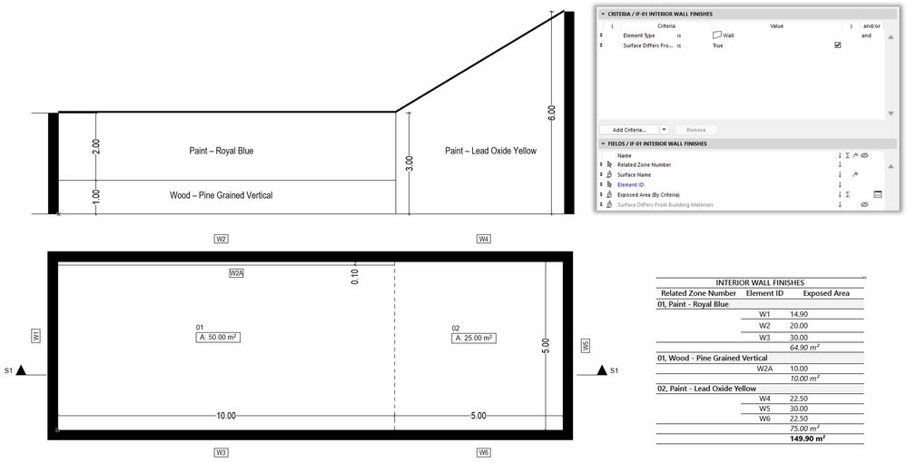

To obtain a fairly accurate QTO for the wall interior finish area, I model each part and paint (overwrite) it with the desired surface (paint, wallpaper, laminate, etc.). I then create a list of surfaces with a criterion to show only painted surfaces and the Exposed Area parameter, as seen in the example below. If desired, you can summarize it by zone and surface. I have made this sample without windows or doors to simplify it, but those areas should also be subtracted if necessary.

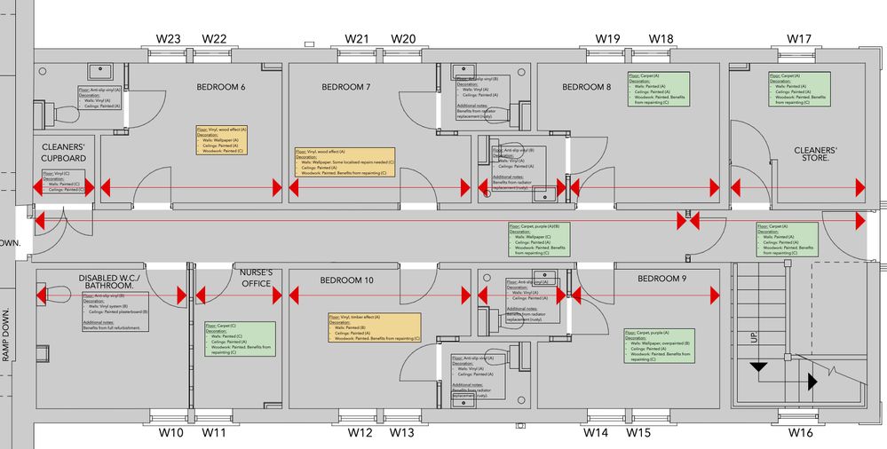

One problem I have with this method is that a single wall can be long enough to separate multiple rooms on each side; and each of these rooms may have different finishes applied to the interior wall surfaces. In a situation like this, how do I tackle the different paint colors/wallpapers/other cladding that may be required?
In this example I show a long corridor with residential rooms either side of it. The long walls on either side of the corridor are decorated in a single manner on the corridor's side, but the decoration may change from room to WC to another room/WC etc on the other side of the wall. If I use the wall schedule instead of a zone one, how do I extract those different surface areas?
One solution might be to segment the long wall to many shorter ones, all lining up to form the 'single' longer wall. But even that may be problematic: room segmentation may occur at different points along the length of the wall on its two sides. The way I am thinking about it, that could end up with a much more complex model (because of the multiple shorter walls versus the ideal, single, longer wall).

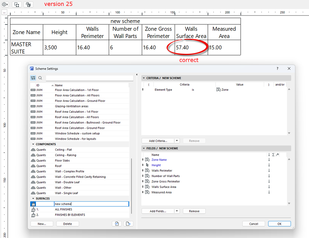

I just tried with your zone dimensions in version 25.
Perfect.
I copied this across to 28 29 and there is definitely a difference that I don't think should be there.
My walls were 230mm thick.
Adjusting the wall thickness does make a difference in 29, 25 remains perfect.
It appears to be deducting the thickness of one wall by the height from the total surface area when it should not be doing this.
In my case 0.805.
56.6 + 0.80 = 57.4
I would report this to your local support people and ask them to investigate.
I will also report this as a bug, as it is important, people are trusting these figures.

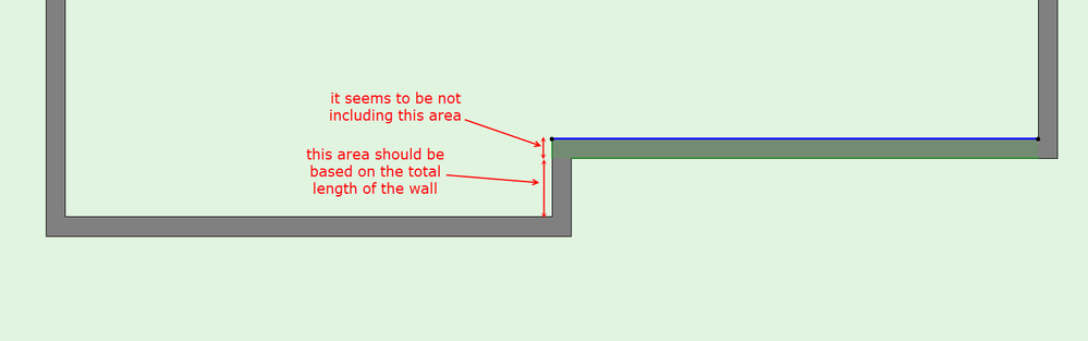

I can see the error.
It is subtracting one end wall surface area when it shouldn't be.
