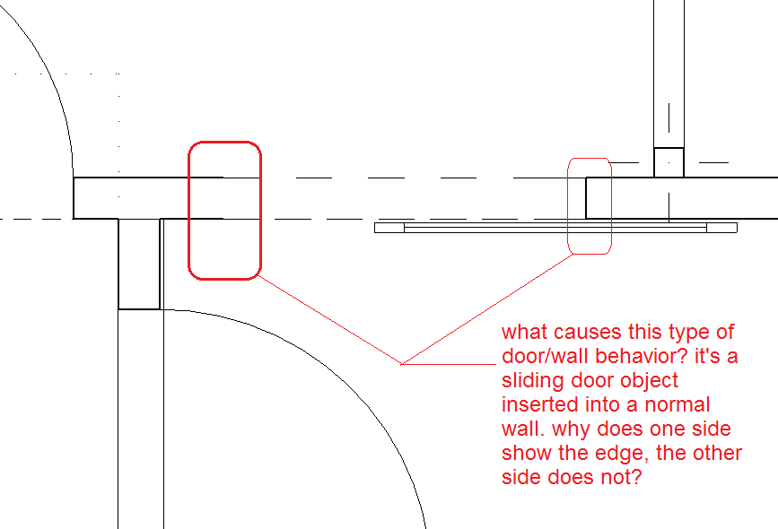

Door closures at walls? why does this behavior occur?
rob2218
see attached.

Do you have any other objects underneath the door? Or maybe in some other layer that is masked? Or even in the renovation filter?
Check if any of those sorts the problem
David Maudlin
Rockstar
Rob:
One thing to check on the door is General Settings > Ganging.
David
