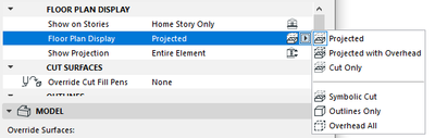

Or it could be the wall that the door is in.  If you have the floor plan display option of the wall set to 'Outline only' then change it to 'Projected'
