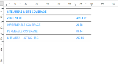

so i took your advice and started with the renovations system. now the main issue that i have is the scheme settings and schedules. i cant seem to get the tables to show different elements on different renovations status. even though i putting criteria as renovation status but its still not showing.
any advice ? please see attached. im after a zone called building footprint. as soon as i put this zone on no filters renovation it shows.
I am not 100% sure if this will help but try changing one of the criteria options to 'AND'.
You are looking for a zone in a particular layer AND with a particular renovation status.
ahmad525
yeah that didn't work as well. i think im missing something. ill keep trying different stuff to see if it works.
