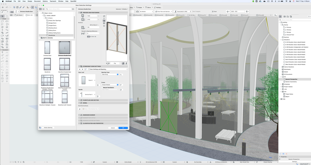

Currently working on a project where i would like the doors to use style 6 (a glass based door leaf), with the vertical bar 6 style of handle. Unfortunately, when these settings are applied it doesn't show up in the render or the 3D viewer.  I am rendering with Maxon if thats any help.
All help appreciated!
Thanks 
1 REPLY 1
Lee Hankins
Check the detail level in the Model View Options for doors in 3D and Section view. You may have the level set to low so the detail of the door panel isn’t shown. Change it to a higher detail level and it should show what you want.
