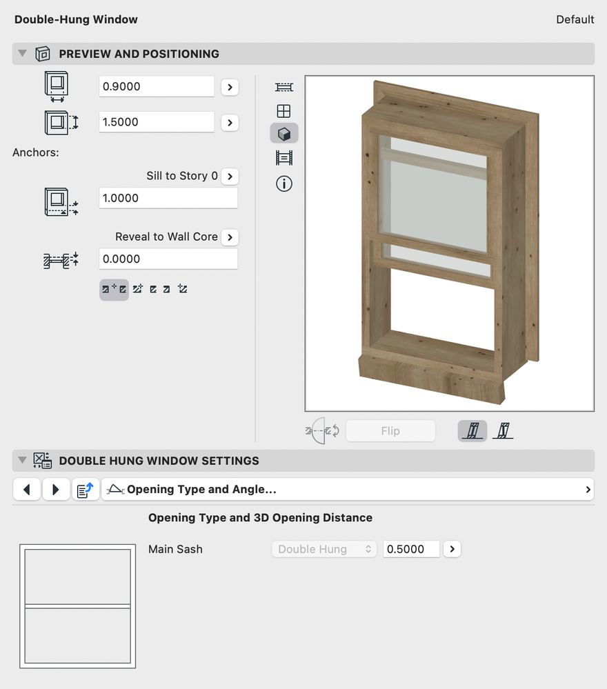

It's all in the subject, guys. I can't find how the two objects differ. Am I being blind or is it a bug?
To confirm: I can't see how to show the top half of the window in a not-closed state. Unless - am I misunderstanding the meaning of 'double-hung'?
Archicad 29.0.2 (3200) INT; macOS Sonoma
1 Reply 1

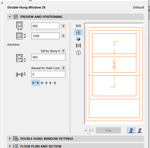

The double hung window seems to only allow the bottom sash to open.
However it will show the opening direction lines for both sashes.
