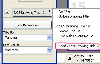

You should put your custom title in your Office Library. Then, when you select a drawing, choose 'Load Other Drawing Title'.
