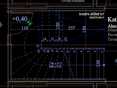

Drawing stair
how can i draw a ladder like this?

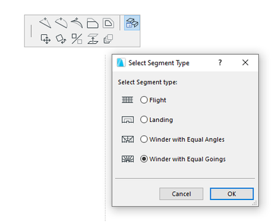

Draw a U stair with the reference line on the outside. Add a new node on the door side. Click on the edge below your door and set the section to Winder with Equal Goings.

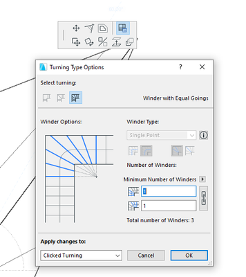

Click on the corner node away from the door where you winders are and edit the Turning Type Options to get your desired turning spread.
