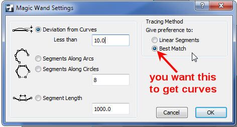

Why are slabs that are drawn with arcs or splines in plan view shown segmented in 3d? This leads to morphs with segmented edges instead of curved edges. Do I have to draw them in the 3d window in order to get truly curved edges?

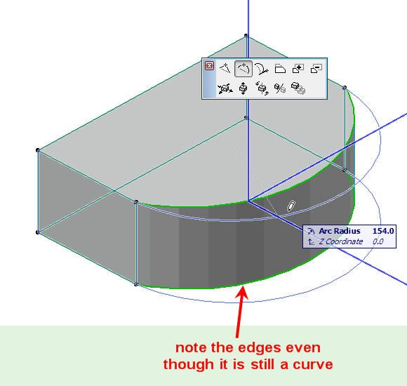

There is no such thing as a true curve in 3D.
It may still behave as an arc or circle (i.e. stretchy radius) but it is actually made up from many straight edges.
The number of edges is controlled in your Magic Wand settings.
You may also have the magic wand settings to use a tracing method of "Linear Segments" rather than "Best Match" which will give you curves.

The magic wand settings.

There seems to be a limit to the resolution. The piece I am trying to create is 16" x 4". I can't get the magic wand settings to a high enough resolution to make the curves look curved in 3d. They always look segmented. I tried Deviation from curves (minimum seems to be 3/64"), Segments along arcs, and Segmented length (Minimum is 25/64"). None of them are acceptable.
