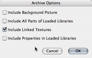

as far as what's happening: this is a library part - most likely a window - that calls another library part (a 'macro') as a part of the script that generated it. the macro it's calling 'wa_trim_us 81.gsm' is responsible for generating the trims around that window. i would expect that somewhere in your project you have a couple of windows with their trims turned on, yet the parameter values you have entered for those trims are 'bad' (like a negative number or something).
if nobody using the US library replies to this, e-mail me your project zipped and in archive format (File>Save As... and choose 'ArchiCAD Archive Project' as the file format) to the address in my signature below and i'll have a look . . .

keshav wrote:
The file size is around 20mb. Can I still email it to you?
no! have you zipped it?
also: make sure your 'save as archive' options resemble the attached screenshot:
~/archiben
b e n _ f r o s t
