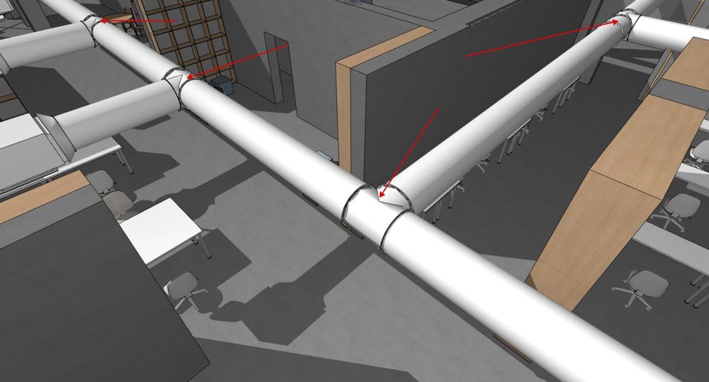

Hi. In archicad 28 with national libraries (not monolith) is big problem with MEP approximation or detailing presentation. There are in script 3 model views - simple, detailed and off, but simple and detailed are same in 3d view. Please correct this error. It is terrible because we use models also for demonstration to clients. Look to Revit MEP - absolutely full library, also you can parametrize it and edit fully!!!

Do you use Template from AC27 ? I just faced this problem. it might occur when you use template and environment profile from AC27. and also please check your branch table that you input the right distance.

No, I use library libpacks national (new, from AC 28), not 27, not 28 monolith, not migrated.
