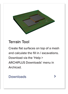

hi all,
anyone knows if this terrain tool (addon) or a similar one is also available in English?
https://helpcenter.graphisoft.com/de/user-guide/38118/
I would vote for a central register for all free available Archicad Addons 😉
BR, Florian
AC25, BIMCloud, Windows

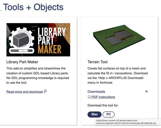

Miha_M
I think the same tool is available in english, here the manual (v21, but there is a v26 addon available). You can download it on the UKI GS pages:
Special Tools for Archicad – Graphisoft, but those don't work on every localization.

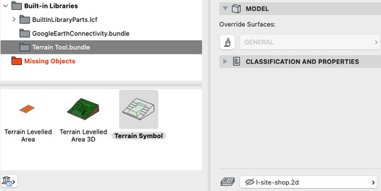

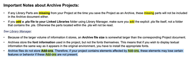

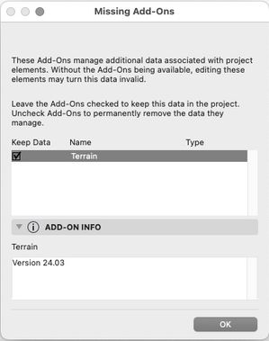

March_ Bruce
Is there an ArchiCAD 28 version of this Add On available ?
In migrating from 26 to 28 either loading or creating an archive library I get an error.
I cannot seem to isolate the add on Terrain Symbol.gsm in AC26 to export or embed.
This has cost me hours of time trying to find a workaround.
am still waiting on a reply from paid SSA Support...
In the SSA downloads I find an AC28 Library Part Maker & TerrainTool_26.03+macOS_USA.zip
This does not seem to work with AC28.
Is migration currently impossible..?
Any help appreciated with many thanks...
